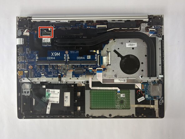

    1. HP ProBook 455 G7 Wi-Fi Card Replacement, Wi-Fi Card: step 4, image 1 of 1
      • The Wi-Fi card is a small rectangular module secured with one screw.
      Ask FixBot
    2. HP ProBook 455 G7 Wi-Fi Card Replacement: step 5, image 1 of 1
      • Use the tip of a spudger to pry up and disconnect the two antenna wires (black and white) attached to the Wi-Fi card.
      • Note their original positions (usually labeled MAIN and AUX).
      Ask FixBot
    3. HP ProBook 455 G7 Wi-Fi Card Replacement: step 6, image 1 of 1
      • Unscrew the single Phillips screw holding the card in place.
      • The card will pop up at a slight angle.
      • Gently pull the Wi-Fi card out of its socket.
      Ask FixBot
