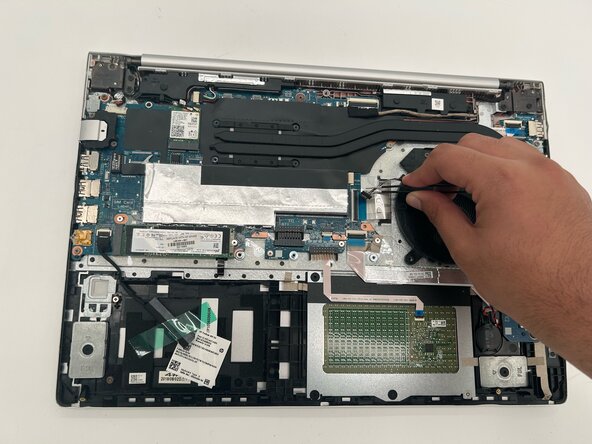

    1. HP ProBook 450 G6 Fan Replacement, Fan: step 5, image 1 of 3 HP ProBook 450 G6 Fan Replacement, Fan: step 5, image 2 of 3 HP ProBook 450 G6 Fan Replacement, Fan: step 5, image 3 of 3
      • Disconnect the fan connector from the system board. Remove any tape securing the cable as needed.
      Ask FixBot
    2. HP ProBook 450 G6 Fan Replacement: step 6, image 1 of 3 HP ProBook 450 G6 Fan Replacement: step 6, image 2 of 3 HP ProBook 450 G6 Fan Replacement: step 6, image 3 of 3
      • Remove the Phillips M2.0x4.0 screw securing the fan to the Probook.
      • Slide the fan to the left out from under the heat sink and remove the fan from the Probook.
