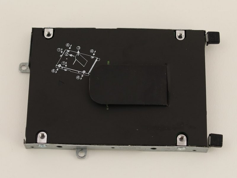

    3. HP ProBook 450 G4 Hard Drive Replacement: step 3, image 1 of 2 HP ProBook 450 G4 Hard Drive Replacement: step 3, image 2 of 2
      • Use the Phillips #0 screwdriver to remove the black 3.2mm screw that secures the hard drive to the left side of the laptop.
      Ask FixBot
    4. HP ProBook 450 G4 Hard Drive Replacement: step 4, image 1 of 2 HP ProBook 450 G4 Hard Drive Replacement: step 4, image 2 of 2
      • Use the spudger to lift the left side of the hard drive up.
      • Pull the hard drive diagonally to the left to release the hard drive from the laptop.
