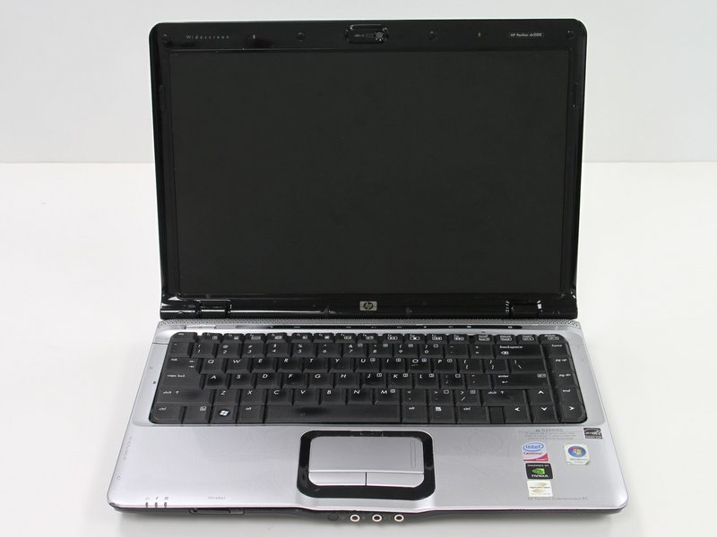

Be sure to turn off the computer and remove the battery in order to avoid any electrical hazards and further damages to the hard drive. An improper shutdown or the hard drive receiving power while being removed may lead to file corruption.

    1. HP Pavilion dv2700 Hard Drive Replacement, Hard Drive: step 1, image 1 of 1
      • To remove the battery, pull the tab to the left and lift the battery from the computer.
      Ask FixBot
    2. HP Pavilion dv2700 Hard Drive Replacement: step 2, image 1 of 1
      • Using a #0 Phillips Head screwdriver, unscrew the hard drive cover.
      • The screws cannot be removed from the cover.
      • To remove the cover, lift up and to the left.
      Ask FixBot
    3. HP Pavilion dv2700 Hard Drive Replacement: step 3, image 1 of 1
      • Using a #0 Phillips Head screwdriver, remove the screws holding the hard drive in place.
      • These are the two screws located on the right side of the hard drive.
      Ask FixBot
    4. HP Pavilion dv2700 Hard Drive Replacement: step 4, image 1 of 2 HP Pavilion dv2700 Hard Drive Replacement: step 4, image 2 of 2
      • Lift the tab connected to the hard drive in order to remove it.
      • The hard drive may be difficult to remove by grabbing the tab. In this case, use the spudger to gently pry it from the computer.
