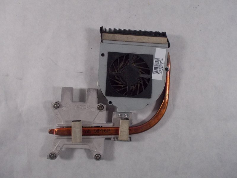

    1. HP Pavilion G60-247CL Fan Replacement, Fan: step 41, image 1 of 2 HP Pavilion G60-247CL Fan Replacement, Fan: step 41, image 2 of 2
      • Locate the fan in the top left corner.
      • Carefully disconnect the wire attached to the motherboard using your fingers.
      Ask FixBot

    8. HP Pavilion G60-247CL Fan Replacement: step 48, image 1 of 2 HP Pavilion G60-247CL Fan Replacement: step 48, image 2 of 2
      • Flip over the motherboard to view the back side.
      • Remove four 1.6 mm screws with a Phillips #1 screwdriver.
      Ask FixBot
    9. HP Pavilion G60-247CL Fan Replacement: step 49, image 1 of 2 HP Pavilion G60-247CL Fan Replacement: step 49, image 2 of 2
      • Gently lift out the fan.
      Ask FixBot
