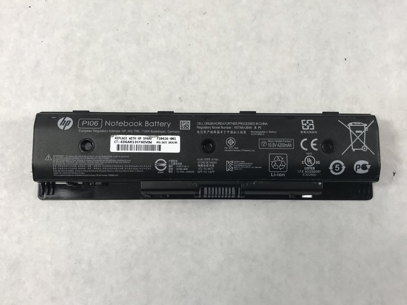

Before attempting to remove the battery from the HP Pavilion 17-e117dx, make sure that it is powered off and nothing is plugged into the laptop. Also, make sure your hands are clean and dry. You will not need any tools for this procedure.
    1. HP Pavilion 17-e117dx Battery Replacement, Battery: step 1, image 1 of 1
      • Turn the laptop upside down, so that the bottom is facing up.
      Ask FixBot
    2. HP Pavilion 17-e117dx Battery Replacement: step 2, image 1 of 2 HP Pavilion 17-e117dx Battery Replacement: step 2, image 2 of 2
      • Slide the battery release latch to the left. The battery will pop up slightly.
      • Lift the battery upwards and out of the laptop.
