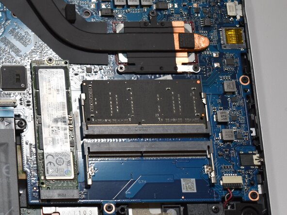

    1. HP Pavilion 15-eg0021nr RAM Module Replacement, RAM Module: step 4, image 1 of 3 HP Pavilion 15-eg0021nr RAM Module Replacement, RAM Module: step 4, image 2 of 3 HP Pavilion 15-eg0021nr RAM Module Replacement, RAM Module: step 4, image 3 of 3
      • Two clips secure the RAM module in place, one on each side. Using your fingers, spread the clips away from the RAM module.
      • Pushing too forcefully on the clips may cause them to bend, rending them incapable or properly securing the RAM stick.
      • Remove the RAM module.
      Ask FixBot
    2. HP Pavilion 15-eg0021nr RAM Module Replacement: step 5, image 1 of 3 HP Pavilion 15-eg0021nr RAM Module Replacement: step 5, image 2 of 3 HP Pavilion 15-eg0021nr RAM Module Replacement: step 5, image 3 of 3
      • To insert the new one slide it in.
      • Note: The new RAM stick will now be at an angle. Not flush with the clips. It will look like the second picture.
      • Press down on the RAM stick and you will hear a click. This ensures that the metal clips have reclipped onto the new RAM stick.
      • Reminder: The last picture shows how the RAM stick looks after it has been fully inserted.
