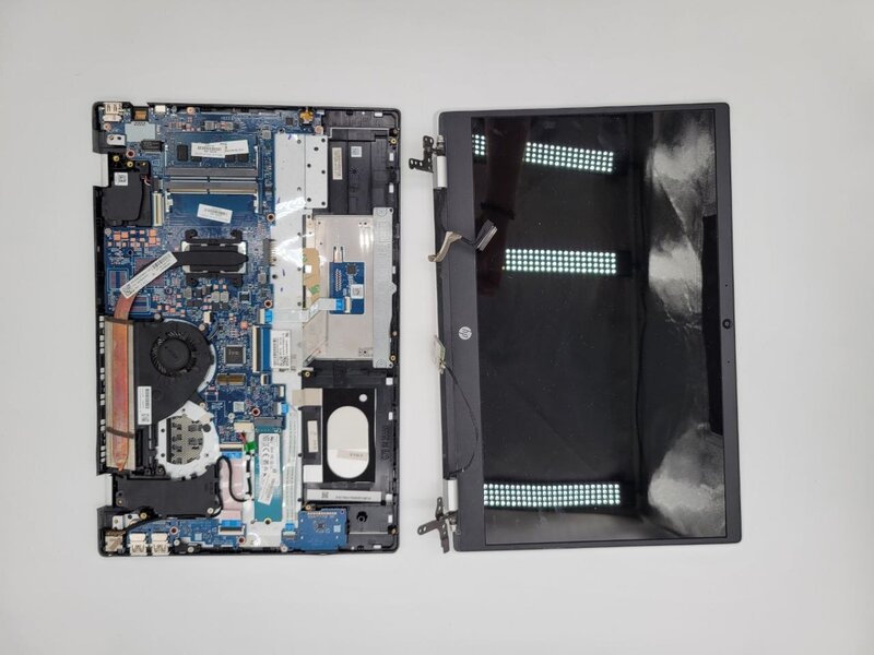

    5. HP Pavilion 15-cs3079nr Display Assembly Replacement: step 11, image 1 of 2 HP Pavilion 15-cs3079nr Display Assembly Replacement: step 11, image 2 of 2
      • Lift and remove the motherboard case section from the display panel component.
      • The hinges may be closely fitted, be careful to avoid damaging component connections.
