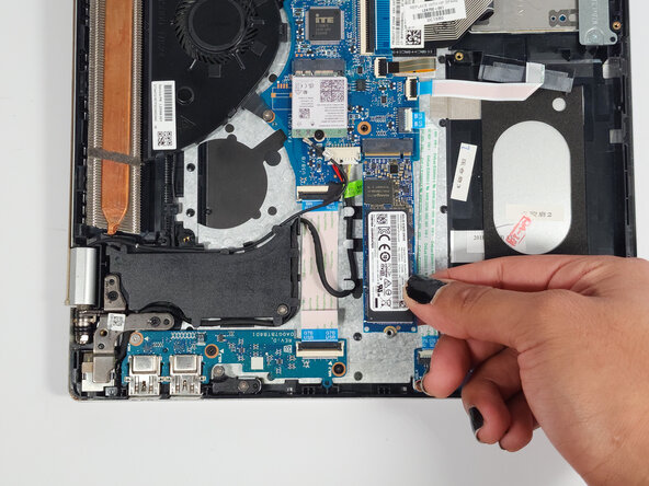

    1. HP Pavilion 15-cs0012cl SSD Replacement, SSD: step 3, image 1 of 2 HP Pavilion 15-cs0012cl SSD Replacement, SSD: step 3, image 2 of 2
      • Turn the laptop 90 degrees to the right for the best working angle.
      • Use a Phillips #0 screwdriver to remove the 3.3 mm screw.
      • Pull the SSD straight out of the slot to remove it.
