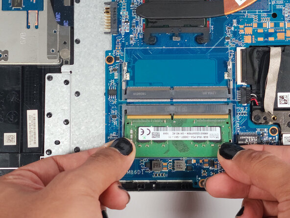

    1. HP Pavilion 15-cs0012cl RAM Replacement, RAM: step 3, image 1 of 3 HP Pavilion 15-cs0012cl RAM Replacement, RAM: step 3, image 2 of 3 HP Pavilion 15-cs0012cl RAM Replacement, RAM: step 3, image 3 of 3
      • Pull the prongs away from the RAM stick to release it.
      • Lift the RAM stick upward, then pull it out of the slot.
