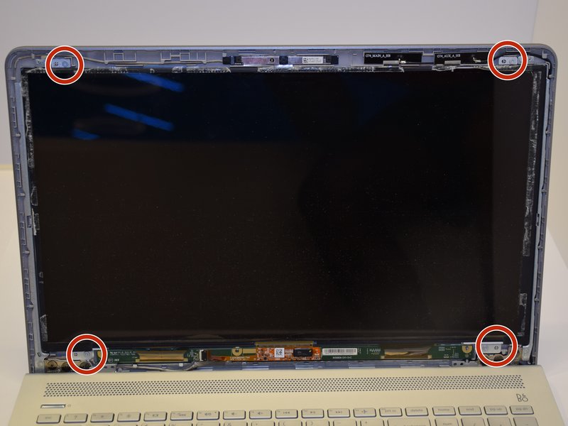

    3. HP Pavilion 15-cc123cl Screen Replacement: step 6, image 1 of 2 HP Pavilion 15-cc123cl Screen Replacement: step 6, image 2 of 2
      • Remove the four 5.5mm frame screws with a Phillips #0 screwdriver that secure the LCD panel.
      • Do not remove the screen after removing the screws.
      • Use a plastic opening tool to pry the screen away from the device.
