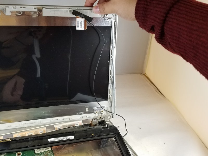

    4. HP Pavilion 14-v062us Screen Replacement: step 13, image 1 of 1
      • Remove the four 5.66 mm PH#0 from under the keyboard near the hinges.
      Ask FixBot
    5. HP Pavilion 14-v062us Screen Replacement: step 14, image 1 of 3 HP Pavilion 14-v062us Screen Replacement: step 14, image 2 of 3 HP Pavilion 14-v062us Screen Replacement: step 14, image 3 of 3
      • Wedge spudger in between screen and back of computer
      • Only use a metal spudger as a last resort. A regular black nylon spudger or a plastic opening tool should be used whenever possible
      • Detach screen
      Ask FixBot
