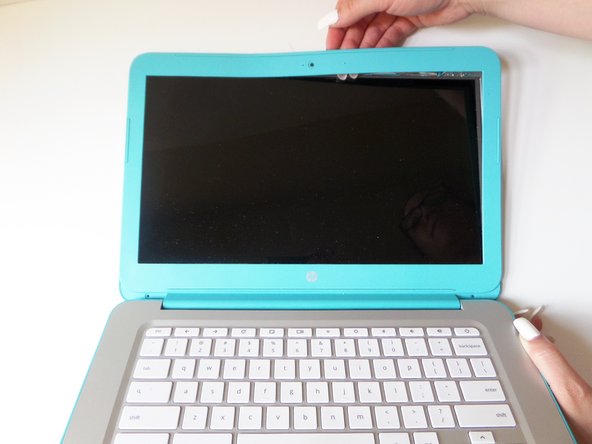

    • With the laptop facing you, open the clamshell. Be sure to turn the power off using a long press before beginning.
    • Remove the screw covers on both sides of the screen bezel by sliding a metal spudger into the crevice and gently peeling the cover away.
    • If the laptop turns on at any point during the repair, quickly turn it off with a long press
