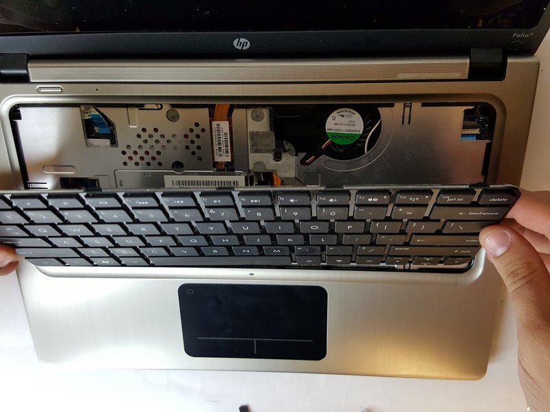

      • To unlock the clamps connected to the motherboard, use your fingers or insert the pointed edge of the spudger between the first clamp and the cable.
      • Repeat the same process for the second clamp.
      Ask FixBot
    6. HP Folio 13t-1000 Keyboard Replacement: step 6, image 1 of 3 HP Folio 13t-1000 Keyboard Replacement: step 6, image 2 of 3 HP Folio 13t-1000 Keyboard Replacement: step 6, image 3 of 3
      • Remove the keyboard from the laptop.
      Ask FixBot

Turn your Folio 13 upside down.
Looking at the screws on the back, work out which ones go into the keyboard to retain it (it’s only 3!).
You only need to take those screws out.
Use something thin and flat to go around the keyboard, separating it from the case front.
It will lift out easily.
There is no need to remove all 16 screws or take the case front off.
