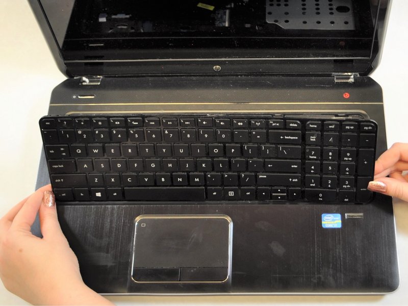

    4. HP Envy dv7t-7200 Keyboard Assembly Replacement: step 12, image 1 of 1
      • The keyboard is still attached by two ribbon cables. Lift the keyboard slowly during this step.
      • Lift keyboard up and place upside down on laptop.
      Ask FixBot
    5. HP Envy dv7t-7200 Keyboard Assembly Replacement: step 13, image 1 of 1
      • Release the connectors that attach the keyboard to the laptop.
      Ask FixBot
    6. HP Envy dv7t-7200 Keyboard Assembly Replacement: step 14, image 1 of 1
      • Remove the keyboard.
      Ask FixBot
