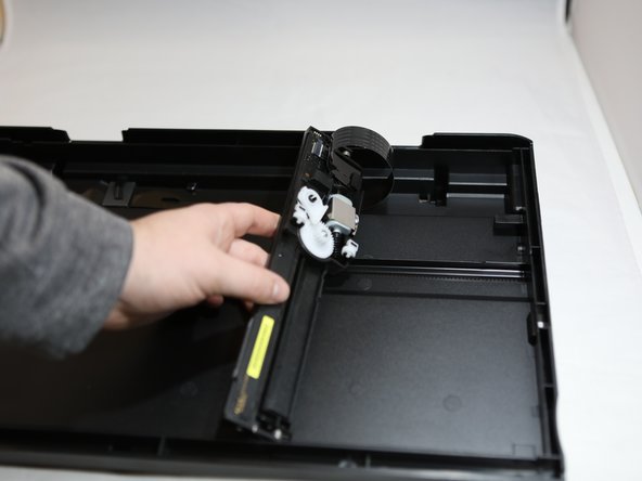

  8. HP Envy 4520 Glass Scanner Bed Replacement: step 8, image 1 of 2 HP Envy 4520 Glass Scanner Bed Replacement: step 8, image 2 of 2
    • Remove the nine 14 mm T10 Hex screws located around the edge of the scanner bed (Bottom).
    • Pry the two plastic flanges outward to release the glass scanner bed.
    Ask FixBot
  9. HP Envy 4520 Glass Scanner Bed Replacement: step 9, image 1 of 3 HP Envy 4520 Glass Scanner Bed Replacement: step 9, image 2 of 3 HP Envy 4520 Glass Scanner Bed Replacement: step 9, image 3 of 3
    • Remove the glass scanner bed.
    • Then to reassemble align the small gear with the track and gently push down.
