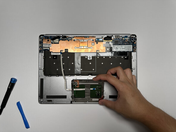

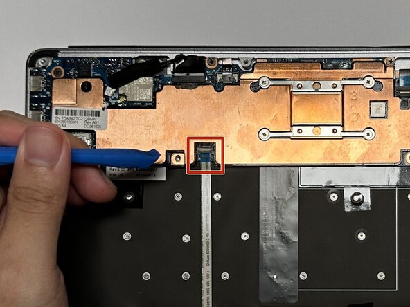

    1. HP EliteBook Folio G1 Trackpad Replacement, Trackpad: step 7, image 1 of 3 HP EliteBook Folio G1 Trackpad Replacement, Trackpad: step 7, image 2 of 3 HP EliteBook Folio G1 Trackpad Replacement, Trackpad: step 7, image 3 of 3
      • Carefully lift the ribbon cable off the motherboard using an opening tool.
      Ask FixBot
    2. HP EliteBook Folio G1 Trackpad Replacement: step 8, image 1 of 1
      • Remove the six 3.0 mm Phillips #00 screws securing the trackpad.
      Ask FixBot

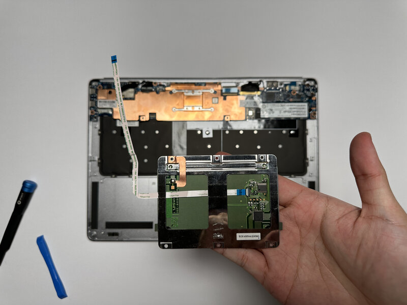

    3. HP EliteBook Folio G1 Trackpad Replacement: step 9, image 1 of 3 HP EliteBook Folio G1 Trackpad Replacement: step 9, image 2 of 3 HP EliteBook Folio G1 Trackpad Replacement: step 9, image 3 of 3
      • Use an opening tool to lift up and remove the trackpad.
