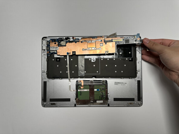

    6. HP EliteBook Folio G1 Display Replacement: step 22, image 1 of 3 HP EliteBook Folio G1 Display Replacement: step 22, image 2 of 3 HP EliteBook Folio G1 Display Replacement: step 22, image 3 of 3
      • Lift the motherboard out of the laptop.
