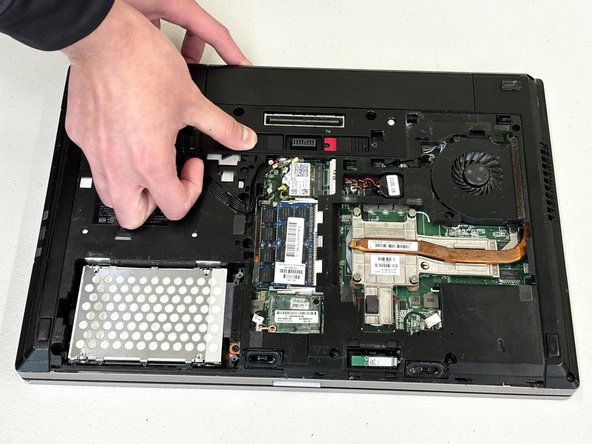

      • Slide and hold the back cover lock all the way to the right.
      • While holding the lock all the way to the right, slide the back cover down and lift the cover.

      • Carefully slide the hard drive to the left and lift it out.
      Ask FixBot

      • Clean the surface and slide in the new hard drive.
