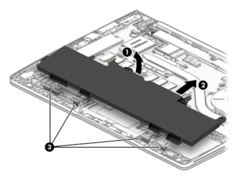

    2. HP EliteBook 830 G5 Battery Replacement, Remove the battery: step 3, image 1 of 2 HP EliteBook 830 G5 Battery Replacement, Remove the battery: step 3, image 2 of 2
      • Disconnect the battery cable from the system board.
      • Remove the five Torx T8 2.5×4.0 screws.
      • Rotate the top of the battery upward, and then lift the battery out of the computer.
      Ask FixBot
To replace the battery & reassemble your device, follow these instructions in reverse order.
