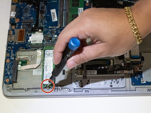

    1. HP EliteBook 725 G4 SDD Replacement, SDD: step 4, image 1 of 2 HP EliteBook 725 G4 SDD Replacement, SDD: step 4, image 2 of 2
      • Remove the one 4 mm screw from the frame.
      • Lift the hard drive out of the laptop.
