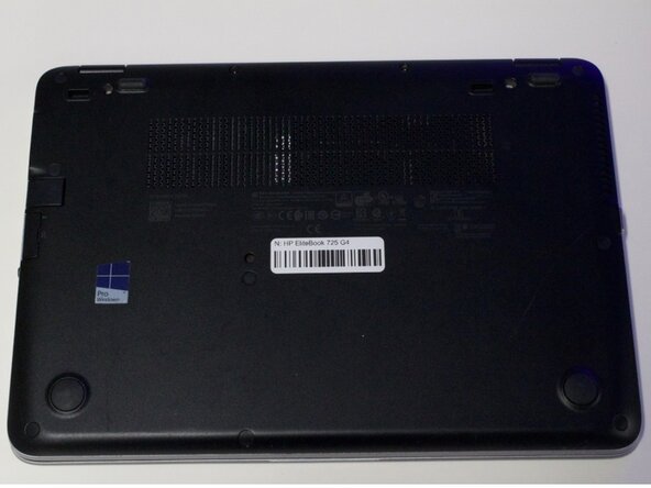

    1. HP EliteBook 725 G4 Back Plate Replacement, Back Plate: step 1, image 1 of 2 HP EliteBook 725 G4 Back Plate Replacement, Back Plate: step 1, image 2 of 2
      • Turn off the computer and make sure the computer is not plugged in.
      • Flip the laptop over on its top.
      Ask FixBot
    2. HP EliteBook 725 G4 Back Plate Replacement: step 2, image 1 of 3 HP EliteBook 725 G4 Back Plate Replacement: step 2, image 2 of 3 HP EliteBook 725 G4 Back Plate Replacement: step 2, image 3 of 3
      • Remove eleven 5 mm screws using a Phillips #0 screwdriver.
      • Remove the SD card insert.
      • Remove the last screw under the SD card insert.
      Ask FixBot
    3. HP EliteBook 725 G4 Back Plate Replacement: step 3, image 1 of 1
      • Use an opening pick to remove the back plate.
