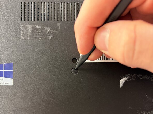

      • Remove the ten 2.5 mm-long Phillips #0 screws securing the lower case.
      Ask FixBot
    2. HP EliteBook 725 G3 Battery Replacement: step 2, image 1 of 2 HP EliteBook 725 G3 Battery Replacement: step 2, image 2 of 2
      • Use the pointed tip of a spudger to remove the rubber stoppers on the lower case.
      Ask FixBot
    3. HP EliteBook 725 G3 Battery Replacement: step 3, image 1 of 3 HP EliteBook 725 G3 Battery Replacement: step 3, image 2 of 3 HP EliteBook 725 G3 Battery Replacement: step 3, image 3 of 3
      • Remove the remaining 2.5 mm-long Phillips screws that secure the lower case.
      • There should be 11 total 2.5 mm-long Phillips #0 screws when you're done.
      • Thelower has a click-release mechanism that is shown in the photos where the SD card is inserted.
      • Push in on this mechanism and remove the lower case.
      Ask FixBot
