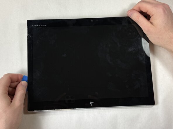

    2. HP Elite x2 G4 Screen Replacement: step 2, image 1 of 3 HP Elite x2 G4 Screen Replacement: step 2, image 2 of 3 HP Elite x2 G4 Screen Replacement: step 2, image 3 of 3
      • Use a suction cup and opening pick to carefully detach the screen from the display assembly in the following order: top-right, top-left, bottom-right, and bottom-left corners.
      • Slide an opening pick around the seam between the screen and back case to release the retaining clips.
      • Leave an opening pick in the space along the perimeter to keep the screen reattaching.
      • Use the suction cup to separate the screen.
      Ask FixBot
    3. HP Elite x2 G4 Screen Replacement: step 3, image 1 of 3 HP Elite x2 G4 Screen Replacement: step 3, image 2 of 3 HP Elite x2 G4 Screen Replacement: step 3, image 3 of 3
      • When lifting the display panel, make sure not to lift it too high, since you'll run the risk of tearing the cables, or damaging the connectors on the board.
      • Slowly lift the display panel until you have access to the battery connector on the motherboard.
      • Use a spudger or a clean fingernail to flip up the black locking flap on the ZIF connector to release the display cable from the motherboard.
      • Use the widest tool possible to avoid damaging the delicate hinge pins.
      • Use tweezers to gently pull the display cable out of its socket.
      • Flip the locking flap up on the touchscreen cable connector and remove the ribbon cable from the board.
      • Remove the screen from the device.
