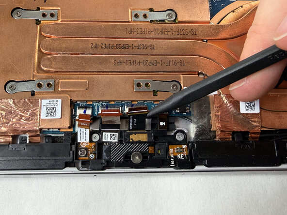

  5. HP Elite x2 G4 Rear Facing Camera Replacement: step 5, image 1 of 3 HP Elite x2 G4 Rear Facing Camera Replacement: step 5, image 2 of 3 HP Elite x2 G4 Rear Facing Camera Replacement: step 5, image 3 of 3
    • Use a spudger or a clean fingernail to flip up the locking flaps on the four ZIF connectors.
    • Use tweezers or your fingers to gently remove the four ribbon cables from their sockets to disconnect the camera.
