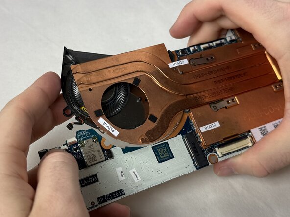

    9. HP Elite x2 G4 Fan Replacement: step 15, image 1 of 3 HP Elite x2 G4 Fan Replacement: step 15, image 2 of 3 HP Elite x2 G4 Fan Replacement: step 15, image 3 of 3
      • Removing the fan from the motherboard is a little tricky.
      • Gently pry the circuit board from the heatsink to allow enough space to access the fan.
      • Slide the fan out from between the board and heat sink.
      Ask FixBot
    10. HP Elite x2 G4 Fan Replacement: step 16, image 1 of 1
      • The fan can now be replaced or cleaned throughly.
