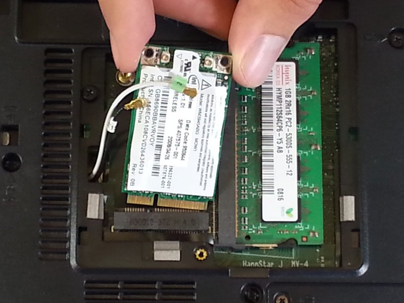

      • Using a blue plastic prying tool, gently pry off the 2 connectors.
      • The black cable goes on the connection closer to where the cables originate, while the white cable goes on the farther connection.
      Ask FixBot
    3. HP Compaq 6710b Wireless Card Replacement: step 4, image 1 of 2 HP Compaq 6710b Wireless Card Replacement: step 4, image 2 of 2
      • Using the Phillips #1 screwdriver, unscrew the 2 3mm screws.
      • Adaptor is spring-loaded.
      • You can now take out the adaptor.
