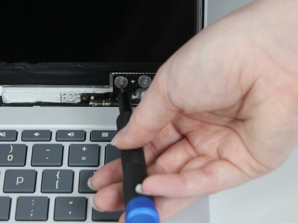

  3. HP Chromebook 14a-nf009nr Display Cable Replacement, Screen: step 3, image 1 of 2 HP Chromebook 14a-nf009nr Display Cable Replacement, Screen: step 3, image 2 of 2
    • Use a Phillips #1 screwdriver to remove the four 5 mm screws securing the hinges.

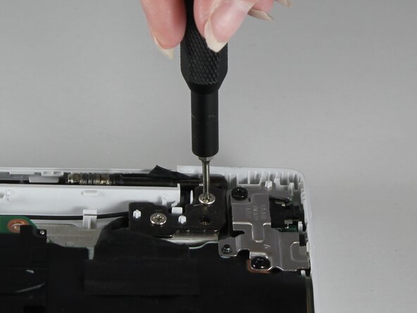

  7. HP Chromebook 14a-nf009nr Display Cable Replacement: step 7, image 1 of 2 HP Chromebook 14a-nf009nr Display Cable Replacement: step 7, image 2 of 2
    • Use the Phillips #1 screwdriver to remove the six 5 mm screws securing the hinges.
    • Use the Phillips #1 screwdriver to remove the 2.5 mm screws securing the hinges.

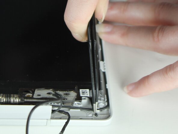

  9. HP Chromebook 14a-nf009nr Display Cable Replacement: step 9, image 1 of 1
    • Use the iFixit opening tool to remove the display bezel screen frame.
    • Be gentle so as to not crack the screen.
