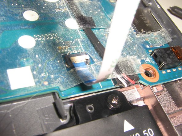

  2. HP Chromebook 14-db0000 Battery Replacement, Disconnect Keyboard Ribbon Cable: step 2, image 1 of 3 HP Chromebook 14-db0000 Battery Replacement, Disconnect Keyboard Ribbon Cable: step 2, image 2 of 3 HP Chromebook 14-db0000 Battery Replacement, Disconnect Keyboard Ribbon Cable: step 2, image 3 of 3
    • VERY CAREFULLY Disconnect the KEYBOARD RIBBON CABLE

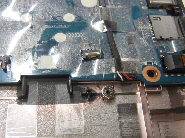

  3. HP Chromebook 14-db0000 Battery Replacement, Disconnect Trackpad Ribbon Cable: step 3, image 1 of 3 HP Chromebook 14-db0000 Battery Replacement, Disconnect Trackpad Ribbon Cable: step 3, image 2 of 3 HP Chromebook 14-db0000 Battery Replacement, Disconnect Trackpad Ribbon Cable: step 3, image 3 of 3
    • VERY CAREFULLY Reconnect the TRACKPAD RIBBON CABLE
  4. HP Chromebook 14-db0000 Battery Replacement, Remove Old Battery: step 4, image 1 of 3 HP Chromebook 14-db0000 Battery Replacement, Remove Old Battery: step 4, image 2 of 3 HP Chromebook 14-db0000 Battery Replacement, Remove Old Battery: step 4, image 3 of 3
    • Disconnect Battery Cable from Mainboard
    • Remove the Four (4) Screws that are holding the battery down.

  6. HP Chromebook 14-db0000 Battery Replacement, Reconnect Trackpad Ribbon Cable (Reverse of Step #3): step 6, image 1 of 3 HP Chromebook 14-db0000 Battery Replacement, Reconnect Trackpad Ribbon Cable (Reverse of Step #3): step 6, image 2 of 3 HP Chromebook 14-db0000 Battery Replacement, Reconnect Trackpad Ribbon Cable (Reverse of Step #3): step 6, image 3 of 3
  7. HP Chromebook 14-db0000 Battery Replacement, Reconnect Keyboard Ribbon Cable (Reverse of Step #2): step 7, image 1 of 3 HP Chromebook 14-db0000 Battery Replacement, Reconnect Keyboard Ribbon Cable (Reverse of Step #2): step 7, image 2 of 3 HP Chromebook 14-db0000 Battery Replacement, Reconnect Keyboard Ribbon Cable (Reverse of Step #2): step 7, image 3 of 3
    • VERY CAREFULLY Reconnect the KEYBOARD RIBBON CABLE
