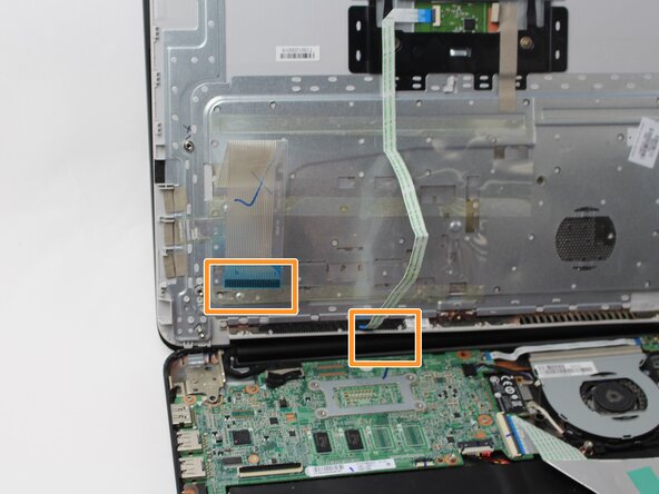

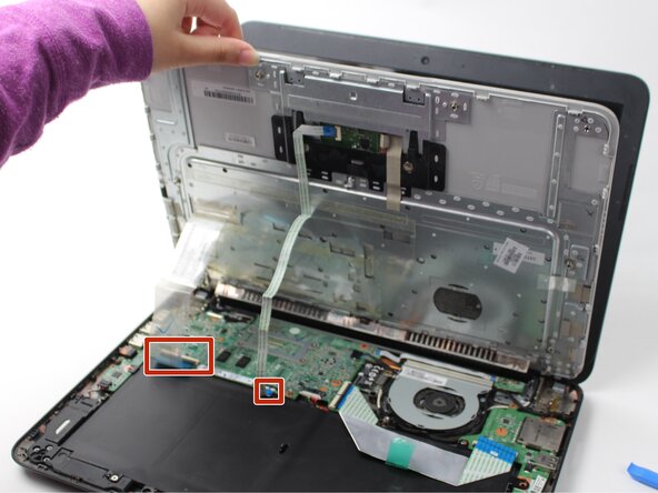

    3. HP Chromebook 14-SMB Battery Replacement: step 3, image 1 of 2 HP Chromebook 14-SMB Battery Replacement: step 3, image 2 of 2
      • Do not pull the keyboard assembly fully away from the laptop yet; it is still connected by fragile ribbon cables.
      • Lift the keyboard perpendicular to the laptop.
      • Flip up each of the two black ZIF locking flaps that secure the keyboard and trackpad ribbon cables to their motherboard sockets.
      • Disconnect the keyboard and trackpad ribbon cables.
      • Remove the keyboard.
