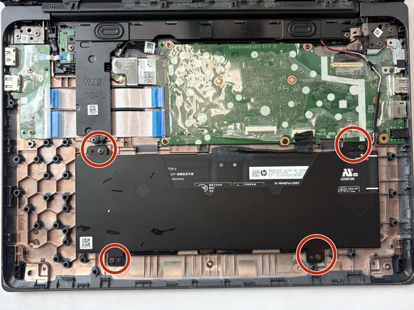

  4. HP Chromebook 14 G6 Touchpad Replacement, Battery: step 4, image 1 of 2 HP Chromebook 14 G6 Touchpad Replacement, Battery: step 4, image 2 of 2
    • Remove the four screws using a Phillips #0 screwdriver.
    • Do not puncture or poke the battery.

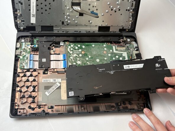

  5. HP Chromebook 14 G6 Touchpad Replacement: step 5, image 1 of 1
    • Lift and remove the battery.
