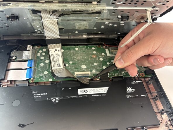

    3. HP Chromebook 14 G6 Keyboard Replacement: step 3, image 1 of 3 HP Chromebook 14 G6 Keyboard Replacement: step 3, image 2 of 3 HP Chromebook 14 G6 Keyboard Replacement: step 3, image 3 of 3
      • Disconnect the two black and white antenna cables with a pair of tweezers.
      • Remove the keyboard.
