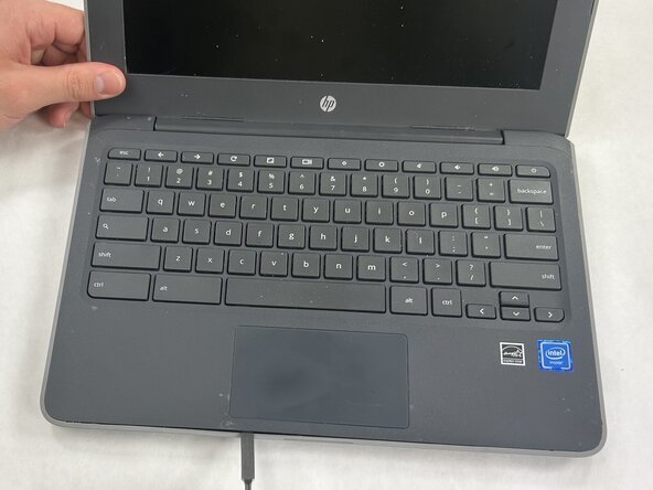

  2. HP Chromebook 11 G7 EE Keyboard Assembly Replacement: step 2, image 1 of 3 HP Chromebook 11 G7 EE Keyboard Assembly Replacement: step 2, image 2 of 3 HP Chromebook 11 G7 EE Keyboard Assembly Replacement: step 2, image 3 of 3
    • Gently lift the keyboard assembly up to allow enough space to disconnect the ribbon cables attached to the motherboard.
    • Use a spudger or a clean fingernail to flip up the black locking flap on the large keyboard cable ZIF connector—this is the unlocked position.
    • Pull the blue pull tab on the keyboard ribbon cable straight out of the connector.
    • Repeat this process for the smaller touchpad ribbon cable next to it.
    Ask FixBot
  3. HP Chromebook 11 G7 EE Keyboard Assembly Replacement: step 3, image 1 of 2 HP Chromebook 11 G7 EE Keyboard Assembly Replacement: step 3, image 2 of 2
    • Remove the keyboard assembly from the device.
    • It should lift away from the device towards the screen if done correctly.
    • The keyboard is bonded to the metal support plate and must be replaced as one complete assembly. The replacement part number is L52573-001.
