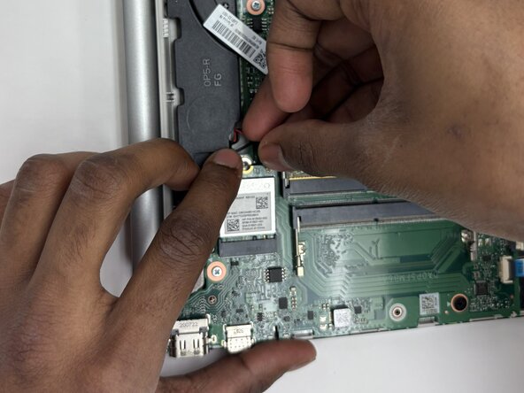

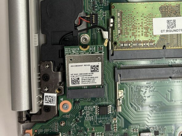

  5. HP 15-ef1041nr Wi-Fi Card Replacement, Wi-Fi Card: step 5, image 1 of 3 HP 15-ef1041nr Wi-Fi Card Replacement, Wi-Fi Card: step 5, image 2 of 3 HP 15-ef1041nr Wi-Fi Card Replacement, Wi-Fi Card: step 5, image 3 of 3
    • Use a Phillips #1 screwdriver to remove the single 2 mm screw securing the Wi-Fi card.
    • Use the pointed end of a spudger to lift and disconnect the Wi-Fi card coaxial connectors.
    • Pull the Wi-Fi card out of its socket at a 45 degree angle.

  6. HP 15-ef1041nr Wi-Fi Card Replacement: step 6, image 1 of 2 HP 15-ef1041nr Wi-Fi Card Replacement: step 6, image 2 of 2
    • Reinsert the new Wi-Fi card into the slot at a 45 degree angle. A small amount of force is required.
    • Press the card down and secure it with the single 2 mm screw.
    • Reattach the coaxial connectors.
