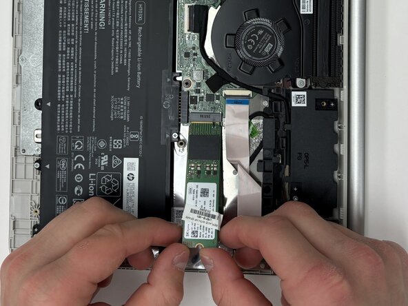

    1. HP 15-ef1041nr SSD Replacement, SSD: step 5, image 1 of 3 HP 15-ef1041nr SSD Replacement, SSD: step 5, image 2 of 3 HP 15-ef1041nr SSD Replacement, SSD: step 5, image 3 of 3
      • Remove the single 2 mm screw that secures the drive with a Phillips screwdriver.
      • Lift the drive up at a 45 degree angle and pull.
      Ask FixBot
    2. HP 15-ef1041nr SSD Replacement: step 6, image 1 of 2 HP 15-ef1041nr SSD Replacement: step 6, image 2 of 2
      • To reinsert the hard drive, start at a 45 degree angle and push the drive into the slot. A small amount of force is required.
      • Hold the stick down and secure the new SSD drive with a 2 mm screw.
