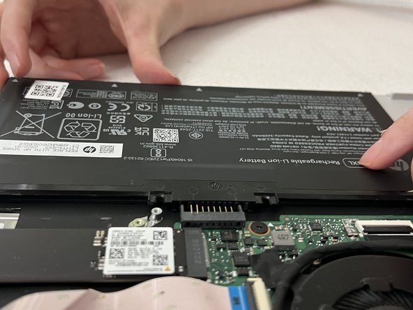

  3. HP 15-dy2046nr Battery Replacement: step 3, image 1 of 3 HP 15-dy2046nr Battery Replacement: step 3, image 2 of 3 HP 15-dy2046nr Battery Replacement: step 3, image 3 of 3
    • Unscrew the 6 Phillips head screws securing the battery.
    • Slide the battery toward you to disconnect it.
    • Remove the battery.
