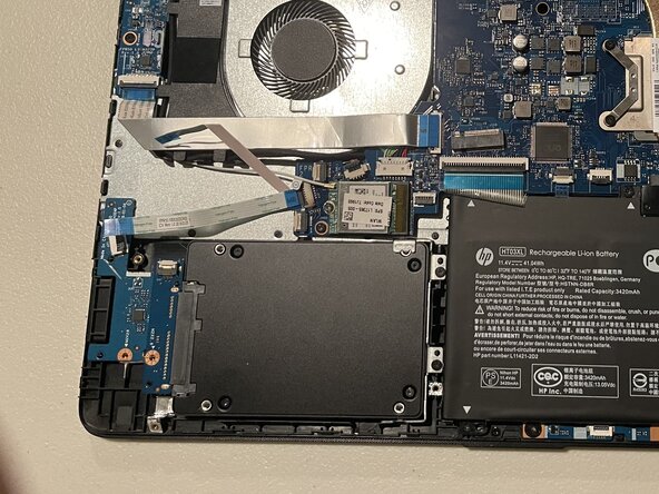

    1. HP 15-dw0037wm SD Card Reader Replacement, SD Card Reader: step 6, image 1 of 2 HP 15-dw0037wm SD Card Reader Replacement, SD Card Reader: step 6, image 2 of 2
      • Flip up the locking flaps securing the HDD and SD reader ribbon cables to the respective boards.
      • Disconnect the two ribbon cables.
      • With a Phillips #0 screwdriver, remove the two 3 mm-long screws that secure the two boards.
      Ask FixBot

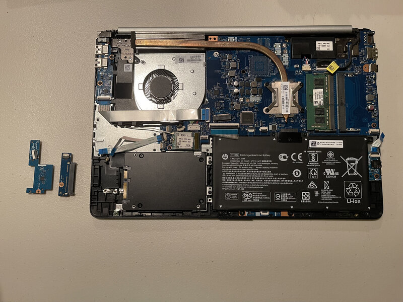

    2. HP 15-dw0037wm SD Card Reader Replacement: step 7, image 1 of 2 HP 15-dw0037wm SD Card Reader Replacement: step 7, image 2 of 2
      • Remove the HDD board.
      Ask FixBot
    3. HP 15-dw0037wm SD Card Reader Replacement: step 8, image 1 of 3 HP 15-dw0037wm SD Card Reader Replacement: step 8, image 2 of 3 HP 15-dw0037wm SD Card Reader Replacement: step 8, image 3 of 3
      • Lift and remove the SD card reader.
      Ask FixBot
