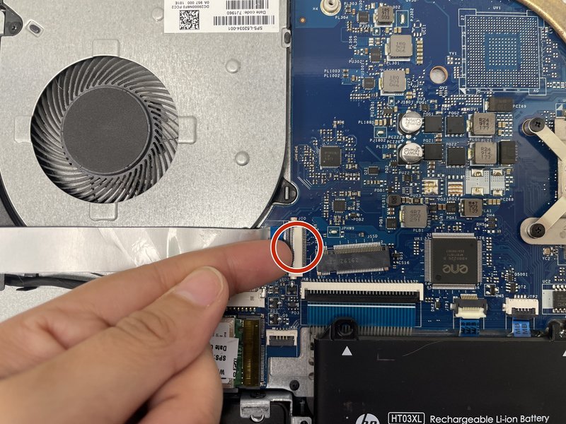

      • Use your fingernail or a spudger to gently lift the black ZIF locking flap that secures the ribbon cable.
      • Repeat the previous bullet on the other end of the ribbon cable.
      Ask FixBot
