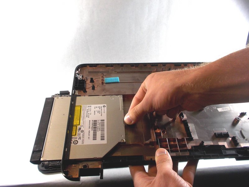

    1. HP 15-ay078nr Optical Drive Replacement, Optical Drive: step 7, image 1 of 1
      • Slide the optical drive outward through the cutout in the device back panel to remove it from the laptop.
