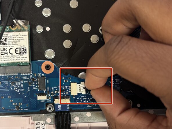

    6. HP 14-ep2011wm Cooling Fan Replacement: step 6, image 1 of 3 HP 14-ep2011wm Cooling Fan Replacement: step 6, image 2 of 3 HP 14-ep2011wm Cooling Fan Replacement: step 6, image 3 of 3
      • Disconnect the cable from the motherboard.
      • Gently unloop the cable out from under the holder attached to the left side of the fan.
