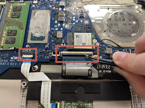

  14. HP 14-dq5009nr Trackpad Replacement: step 14, image 1 of 3 HP 14-dq5009nr Trackpad Replacement: step 14, image 2 of 3 HP 14-dq5009nr Trackpad Replacement: step 14, image 3 of 3
    • Flip up the locking flap on the ZIF connectors that connect to the trackpad and keyboard.
    • Use tweezers or your fingers to gently pull each ribbon cable out of its socket.
    • If the cable has a pull tab, use it to grip the cable. You may damage the cable by gripping it directly.
    Ask FixBot
  15. HP 14-dq5009nr Trackpad Replacement: step 15, image 1 of 3 HP 14-dq5009nr Trackpad Replacement: step 15, image 2 of 3 HP 14-dq5009nr Trackpad Replacement: step 15, image 3 of 3
    • Use the wide end of a spudger to disconnect the 4-pin connector on the motherboard.
    • Avoid pulling on the cables, as they can easily disconnect from the connector.
    • Use the wide end of a spudger to push on the connector tab to slide it out of its socket.
    • Use a spudger to flip up the locking flap on the ZIF connector.
    • Use tweezers or your fingers to gently pull the cable out of its socket.

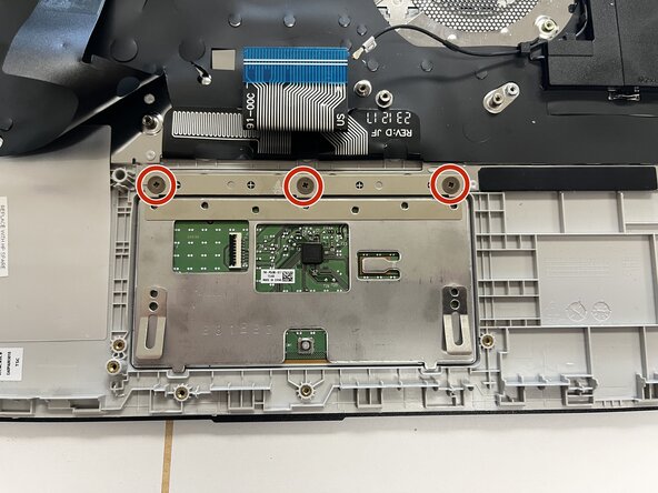

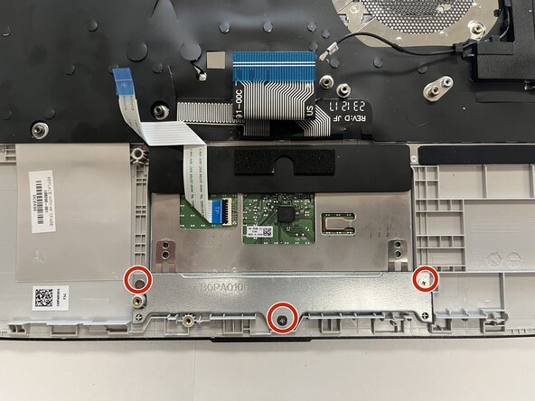

  17. HP 14-dq5009nr Trackpad Replacement, Trackpad: step 17, image 1 of 3 HP 14-dq5009nr Trackpad Replacement, Trackpad: step 17, image 2 of 3 HP 14-dq5009nr Trackpad Replacement, Trackpad: step 17, image 3 of 3
    • Use a Phillips #0 screwdriver to remove the three screws securing the metal bracket at the bottom edge of the trackpad.
    • Remove the bracket at the base of the trackpad.
