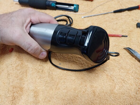

    10. Guide 4: MANDINE MHB1200-20 Hand Blender Machine Assembly.: step 10, image 1 of 2 Guide 4: MANDINE MHB1200-20 Hand Blender Machine Assembly.: step 10, image 2 of 2
      • We check the entire assembly and test that the blender works correctly.
      • These 2 components, bridge rectifier + input fuse, have been the cause of the failure.
      • END of the guide.
