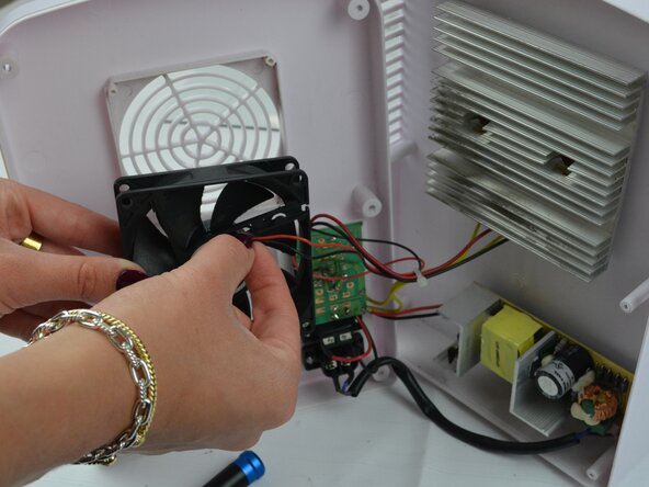

    1. Gourmia GMF600 Internal Fan Replacement, Internal Fan: step 1, image 1 of 3 Gourmia GMF600 Internal Fan Replacement, Internal Fan: step 1, image 2 of 3 Gourmia GMF600 Internal Fan Replacement, Internal Fan: step 1, image 3 of 3
      • Orient the device so the back is facing you.
      • Use a Phillips #1 screwdriver to remove the six screws securing the back panel to the device.

    3. Gourmia GMF600 Internal Fan Replacement: step 3, image 1 of 3 Gourmia GMF600 Internal Fan Replacement: step 3, image 2 of 3 Gourmia GMF600 Internal Fan Replacement: step 3, image 3 of 3
      • Use a Phillips #1 screwdriver to remove the four screws securing the fan.
      • Remove the fan and set it close to the refrigerator.
      • The fan is connected to the Peltier module behind the heat sink and capacitor assembly, so do not pull on it or you may damage the device.
      Ask FixBot
    4. Gourmia GMF600 Internal Fan Replacement: step 4, image 1 of 1
      • Carefully disconnect the cables from the fan to detach it from the board and thermoelectric cooler.
