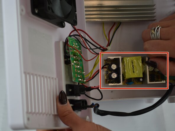

      • Orient the device so the back is facing you.
      • Use a Phillips #1 screwdriver to remove the six screws securing the back panel to the device.

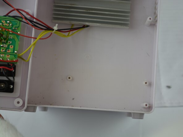

    2. Gourmia GMF600 Capacitor Assembly Replacement: step 2, image 1 of 2 Gourmia GMF600 Capacitor Assembly Replacement: step 2, image 2 of 2
      • Carefully lift the back panel off the refrigerator to reveal the capacitor assembly.

    3. Gourmia GMF600 Capacitor Assembly Replacement: step 3, image 1 of 2 Gourmia GMF600 Capacitor Assembly Replacement: step 3, image 2 of 2
      • Carefully disconnect each cable connecting the capacitor assembly to the main board.
      • Disconnect the black wire and then the red wire.
      • Use precaution when working with electrical wiring. Avoid tugging on wires.
      • Avoid touching the capacitors. They can be dangerous. Ground yourself and use PPE like safety glasses and gloves.
