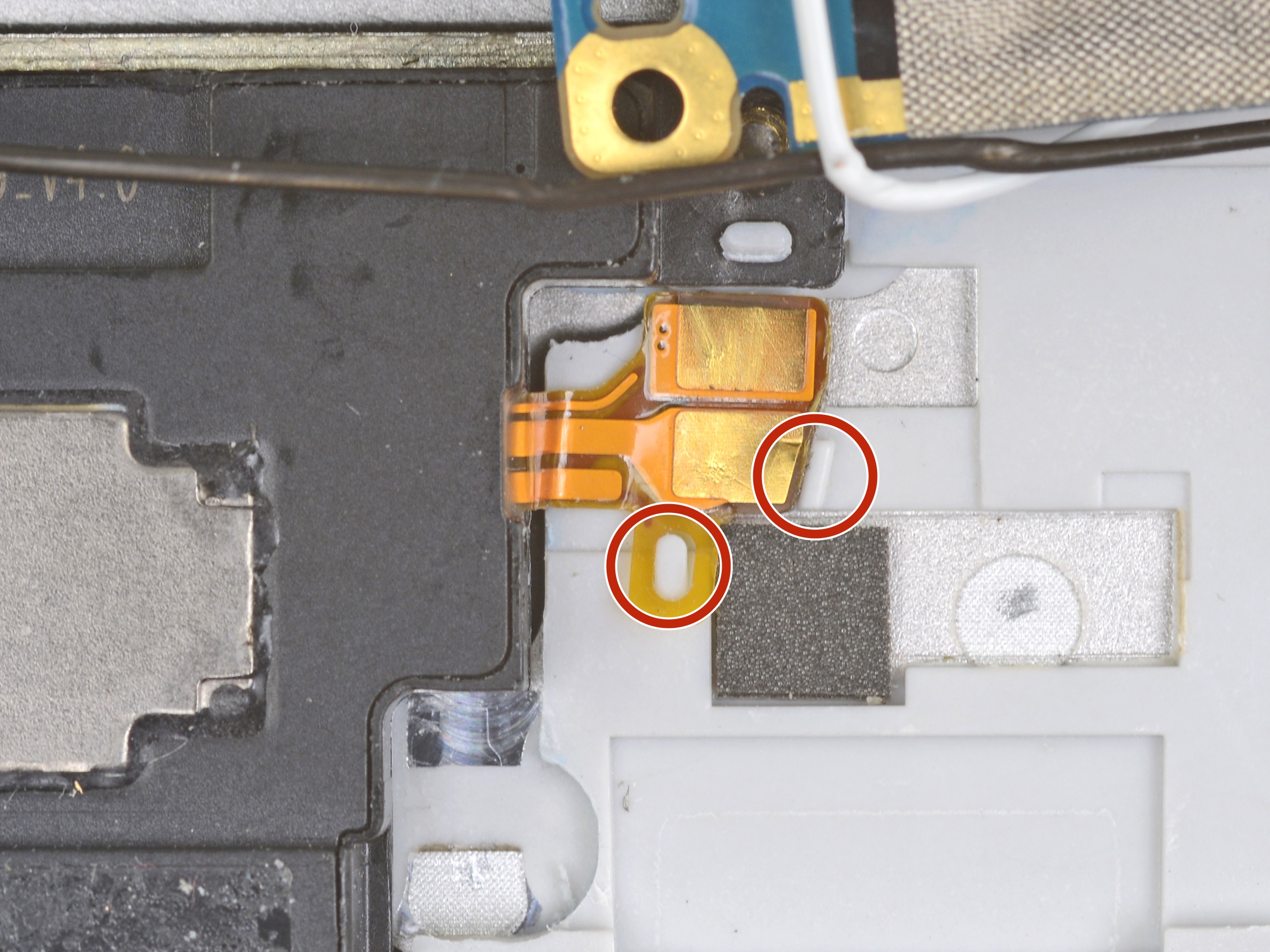

    10. Google Pixel XL Loudspeaker Replacement: step 26, image 1 of 2 Google Pixel XL Loudspeaker Replacement: step 26, image 2 of 2
      • Use the point of a spudger to pry up and loosen the loudspeaker from its recess.
      Ask FixBot
    11. Google Pixel XL Loudspeaker Replacement: step 27, image 1 of 2 Google Pixel XL Loudspeaker Replacement: step 27, image 2 of 2
      • Insert the point of a spudger under the loudspeaker flex cable and pry gently to loosen it from the frame.
      • During reinstallation, make sure that the loudspeaker flex cable is properly seated using the alignment notches. If it is not properly aligned, the loudspeaker will not work.
      Ask FixBot
    12. Google Pixel XL Loudspeaker Replacement: step 28, image 1 of 3 Google Pixel XL Loudspeaker Replacement: step 28, image 2 of 3 Google Pixel XL Loudspeaker Replacement: step 28, image 3 of 3
      • Use the spudger to pry up the loudspeaker.
      • Remove the loudspeaker.
