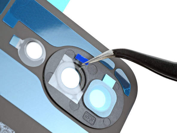

      • Peel all the liners from the interior of the rear cover.
      • Make sure to peel the liners from both camera cutouts.
