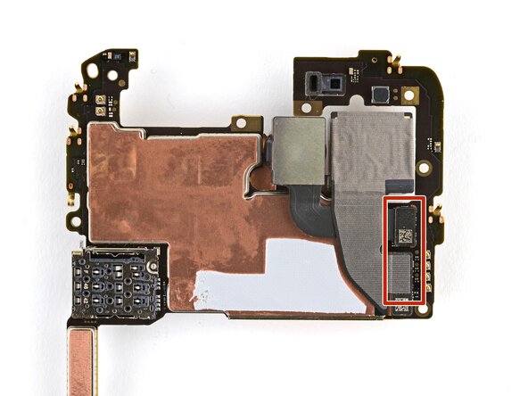

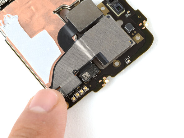

    2. Google Pixel 10a Rear Camera (Wide) Replacement, Remove the wide camera: step 23, image 1 of 2 Google Pixel 10a Rear Camera (Wide) Replacement, Remove the wide camera: step 23, image 2 of 2
      • Insert the point of a spudger under the outer edge of the wide camera connector and pry up to disconnect it.
      Ask FixBot
    3. Google Pixel 10a Rear Camera (Wide) Replacement: step 24, image 1 of 1
      • Remove the wide camera.
      Ask FixBot
