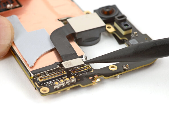

    1. Google Pixel 10a Rear Camera (Ultrawide) Replacement, Remove the ultrawide camera: step 25, image 1 of 3 Google Pixel 10a Rear Camera (Ultrawide) Replacement, Remove the ultrawide camera: step 25, image 2 of 3 Google Pixel 10a Rear Camera (Ultrawide) Replacement, Remove the ultrawide camera: step 25, image 3 of 3
      • Insert the point of a spudger under the marked corner of the ultrawide camera connector.
      • Pry to disconnect the camera.
      Ask FixBot

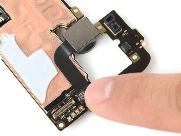

    2. Google Pixel 10a Rear Camera (Ultrawide) Replacement: step 26, image 1 of 1
      • Remove the ultrawide camera.
      Ask FixBot
