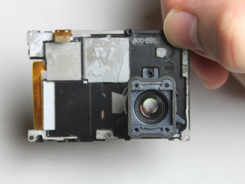

    1. GoPro Hero4 Silver Lens Replacement, Lens: step 9, image 1 of 2 GoPro Hero4 Silver Lens Replacement, Lens: step 9, image 2 of 2
      Tool used on this step:
      Buy
      • Use a pair of tweezers to disconnect the ribbon cable from the ZIF connector by flipping up the black retaining flap. You should then be able to pull the cable free.
      • Once the ribbon cable is disconnected, you can remove the black plastic bracket which holds the camera lens.
      • Be careful removing the ribbon cable. It is very fragile and can tear.
      Ask FixBot
    2. GoPro Hero4 Silver Lens Replacement: step 10, image 1 of 1
      • Remove the three 8 mm Phillips #000 screws securing the lens.
      Ask FixBot
    3. GoPro Hero4 Silver Lens Replacement: step 11, image 1 of 1
      • Pull the camera lens free from the panel.
      Ask FixBot

ok, so i strongly suggest some edits.
First step 5 through 8 don’t need to be done. Step 4 should include removing the 5th screw in the main circuit board, and then on to step 9. Step 9 should also describe the black release lever to unlock the ribbon cable. then the whole front assembly with the lens will come out.
as for the three ribbon cables attached to the back case (for power and the buttons) if they do come out, while the black panel is detached, you need to pull the tape off, lift the three locking levers and very carefully reseat the ribbon cables, reapply the tape and continue with the reassembly
