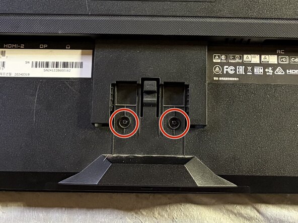

    3. Gigabyte GS32Q-SA Monitor Button Replacement: step 3, image 1 of 3 Gigabyte GS32Q-SA Monitor Button Replacement: step 3, image 2 of 3 Gigabyte GS32Q-SA Monitor Button Replacement: step 3, image 3 of 3
      • Use a Philips #1 screwdriver to remove the two 2.0 mm screws near the bottom center of the monitor.
      • These are the only screws securing the rear housing.
      Ask FixBot

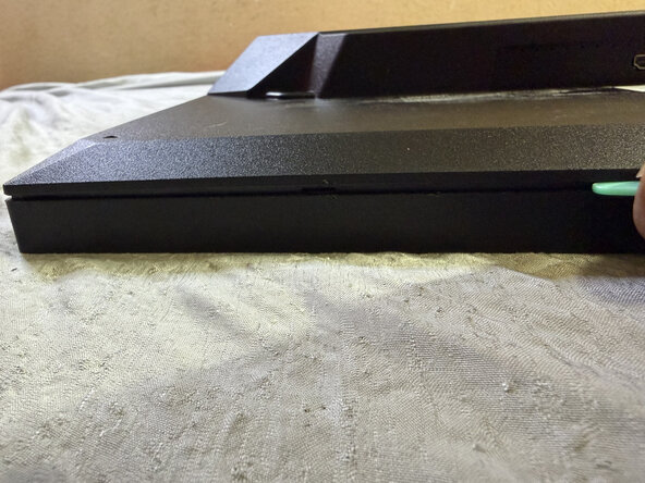

    4. Gigabyte GS32Q-SA Monitor Button Replacement: step 4, image 1 of 3 Gigabyte GS32Q-SA Monitor Button Replacement: step 4, image 2 of 3 Gigabyte GS32Q-SA Monitor Button Replacement: step 4, image 3 of 3
      • Gently insert a plastic opening tool or spudger tool into the seam between the monitor's rear housing and front assembly to create a space.
      • Slide an opening pick around the entire perimeter of the monitor to release the clips holding it together.
      • This initial pass helps release the retaining clips within the monitor and allows the rear housing to be removed safely.
      Ask FixBot
